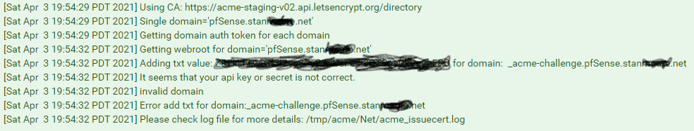

  • ACME GoDaddy api key or secret is not correct
    449 Views

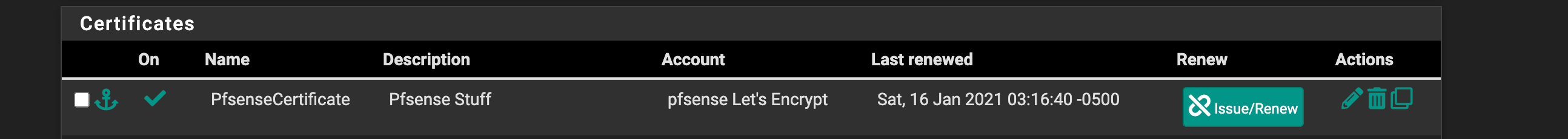

    GertjanG
    [image: 1614800931694-aa4ad270-b4a6-4a6e-adf7-7d7d66ba2bda-image.png] As discussed here a month ago : Let's Encrypt Certificate Authority Expiring soon : do what has been suggested over there. We have 2.5.0 now, the GUI warns us. Still, up to use to use the buttons : [image: 1614801043540-353c0e68-9a66-4784-92f2-2fde461dc2dd-image.png]
