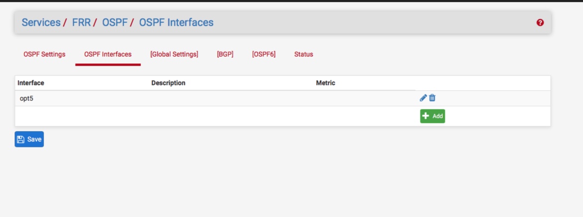

    @gislaved OPNsense 19.1.6-amd64 FreeBSD 11.2-RELEASE-p9-HBSD OpenSSL 1.0.2r 26 Feb 2019 I did more work yesterday and got ospf now working. Initially the opnsense fw connected right out from the initial install to my ubuntu frr ospf on the LAN interface. However after a few hours of configuration and setting up rules and interfaces, I noticed OSPF to be down. by tracing back my steps, on my setup the CARP interface was the issue, apparently you cannot have a virtual carp interface for redundancy and ospf on the same interface. I noticed the "ununumbered" interface on interfaces having CARP enabled: "This interface is UNNUMBERED, Area 0.0.0.0,No Hellos (Passive interface),No Hellos (Passive interface)" As soon as I deleted the CARP config, OSPF came up. My solution was to add a new VLAN interface between the firewalls and all servers in need to custom gateways and run OSPF for routing sync there. last but not least, the OSPF config seems to be very picky, make sure all interfaces are set to broadcast on ethernet connections. In my setup I got a pfsense firewall, one opnsense firewall and several ubuntu VMs connected.
