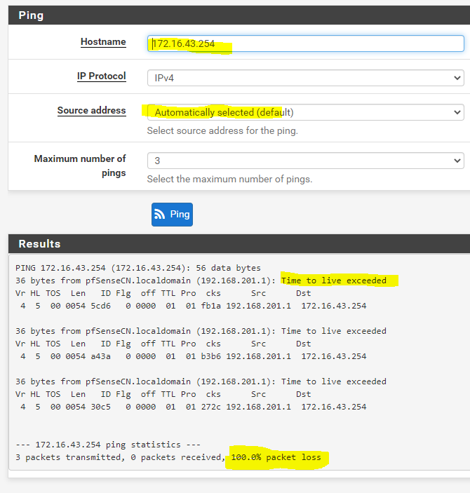

                          If I try to ping from firewall it fails:
                          but if I choose the interface the ping is OK:
                          the solution should be can choose from which interface to start the SMTP connection, but I don't know if it is possible.

                            Ok, then you don't need the LAN gateway or the statis route. That only applies to policy based IPSec connections. Remove them.
                            With a direct routed connection as you have both smtp and ping traffic should use the system routing table to decide which gateway to use. The route you have to 172.16.40.0/22 should be sufficient, if it is in there correctly. Can we see the routing table from pfSense?
