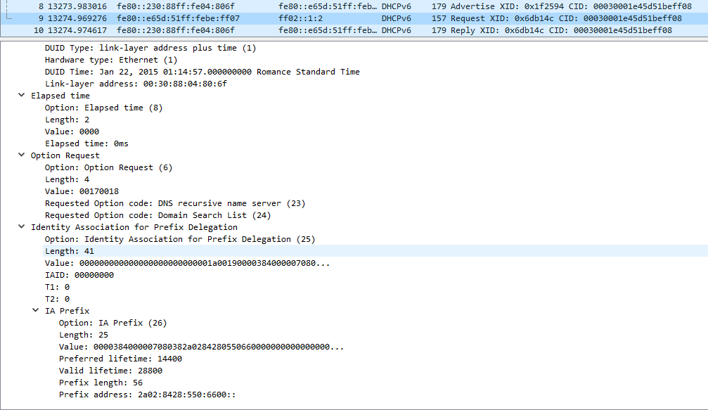

I'm trying to get IPV6 /56 prefix from ISP via RA & DHCPv6 but it seems there is some missing information in the DHCPv6 request coming from pfsense.
On my old Edgerouter 3 (which functions fine with IPV6) I can see this in the capture :
SOLICIT EDGEROUTER :
Here is the solicit from PFSENSE :
After sending a solicit I get a ADVERTISE back from the ISP and then PFSENSE sends a REQUEST but the REQUEST which is sent from PFSENSE is also missing lots of information and the ISP never sends me a REPLY :
REQUEST EDGEROUTER :
Here is the request from PFSENSE
Edgerouter always gets a reply from ISP with prefix but Pfsense does not get reply, the only difference I see is the missing information in screenshots above.

WAN side now has IPV6 prefix :) after setting IPV6 to none then to DHCP multiple times untill somthing in pFsense clicked.
I'm currently running a wirshark to see how the packets are now being sent.
But something is definately broken in PFSENSE.

A packet capture on that provider would be interesting to see.
One from a device that works and one that doesn't.
As has been said, it works great but every ISP IPv6 deployment cannot possibly be tested. Some reliance on the community is required. I, personally, know that dhcp6c works flawlessly with Cox Las Vegas and it works in my lab with DHCPv6 served by pfSense.
Unfortunately, ISPs take great liberties here and some seem to need special sauce to make it work. It's too bad ISPs are less-than-helpful when you try to get the recipe for THEIR SERVICE out of them.
