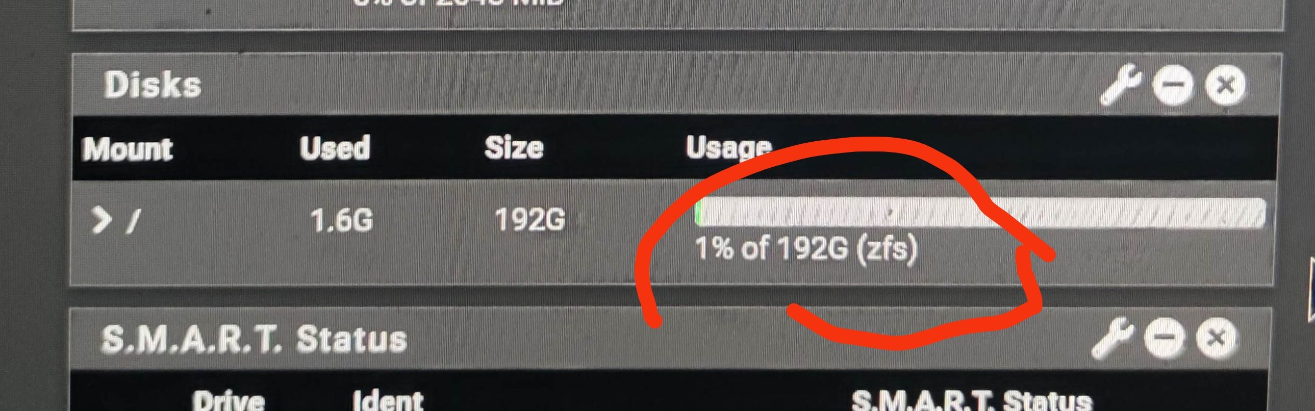

                                        What file system is pfsense installed on?
                                        • F Offline
                                          firefox @w0w
                                          @w0w
                                          Do you mean the format of the disk?
                                          In any case, a small update, I only got to mess with it today
                                          I replaced the computer's memories
                                          There were 4 sticks of 4 gigabytes, that is 16 gigabytes
                                          I removed them and put 2 new ones of 4 GB
                                          Meanwhile the computer is working
                                          I surf through another router
                                          If by the end of the day it doesn't cause problems I will add 2 more new 4 gig sticks
                                          Then wait to see what happens
                                          w0wW 1 Reply Last reply Reply Quote 1
                                          • w0wW Offline
                                            w0w @firefox
                                            @firefox said in pfsense is crashing need help:
                                            https://docs.netgate.com/pfsense/en/latest/install/install-zfs.html
                                            I mean when you have installed it which one filesystem you have been selected? ZFS or UFS?
