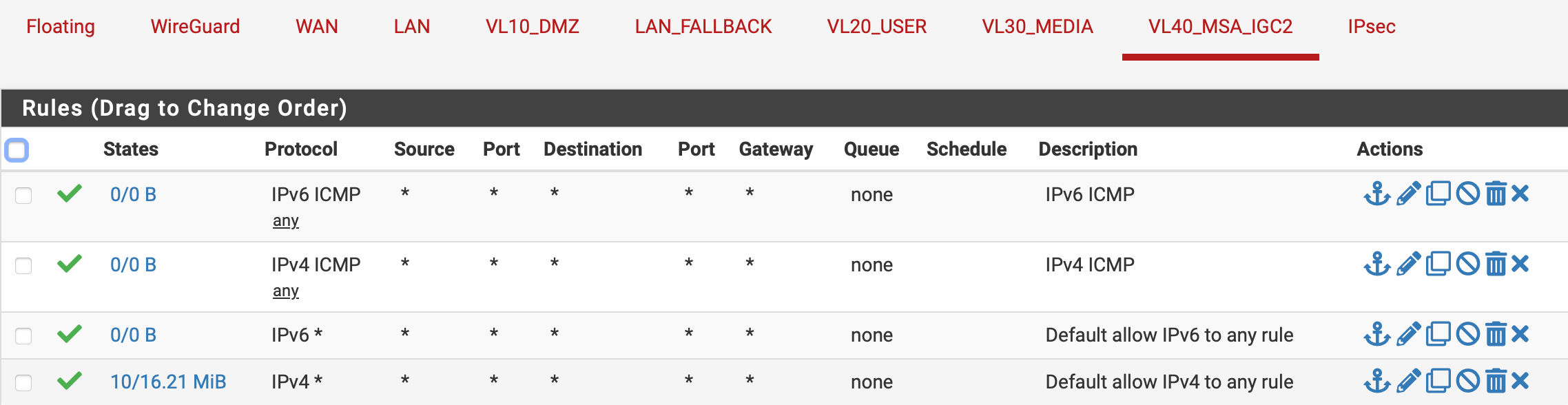

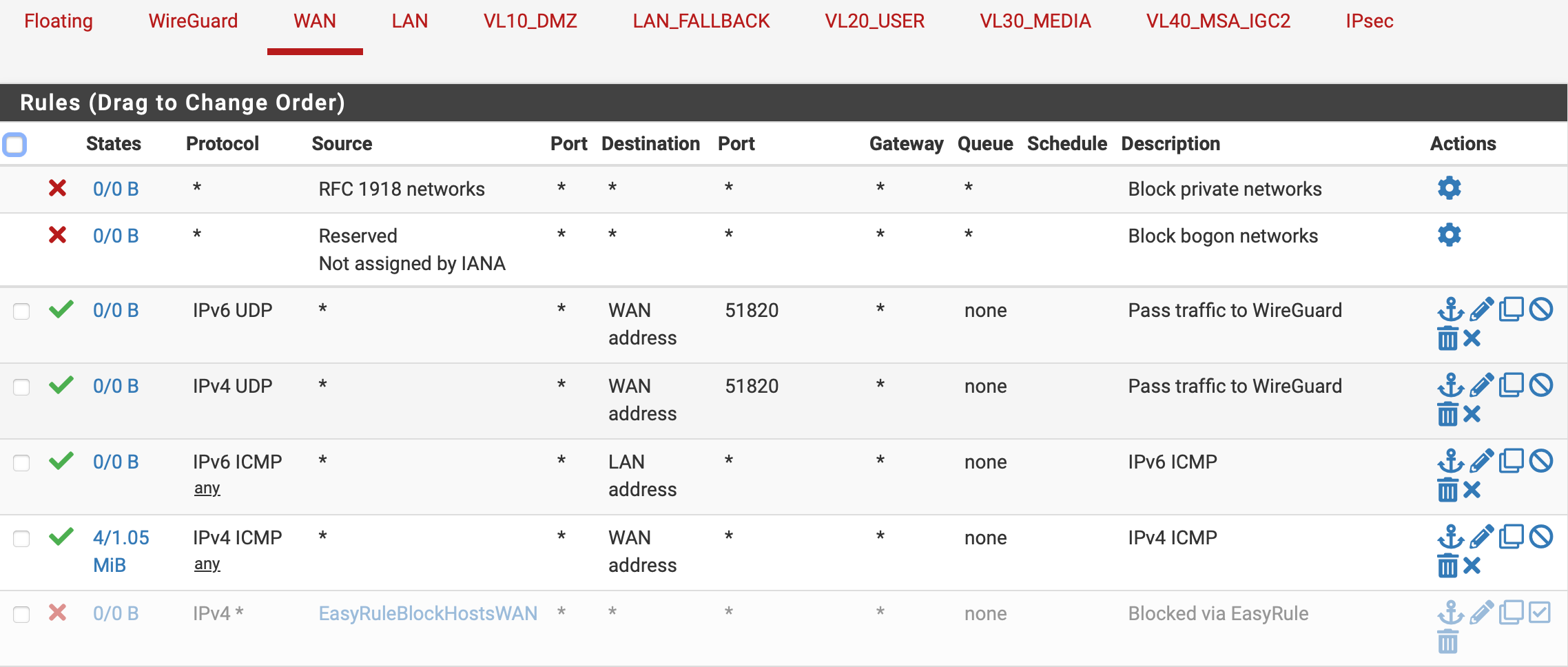

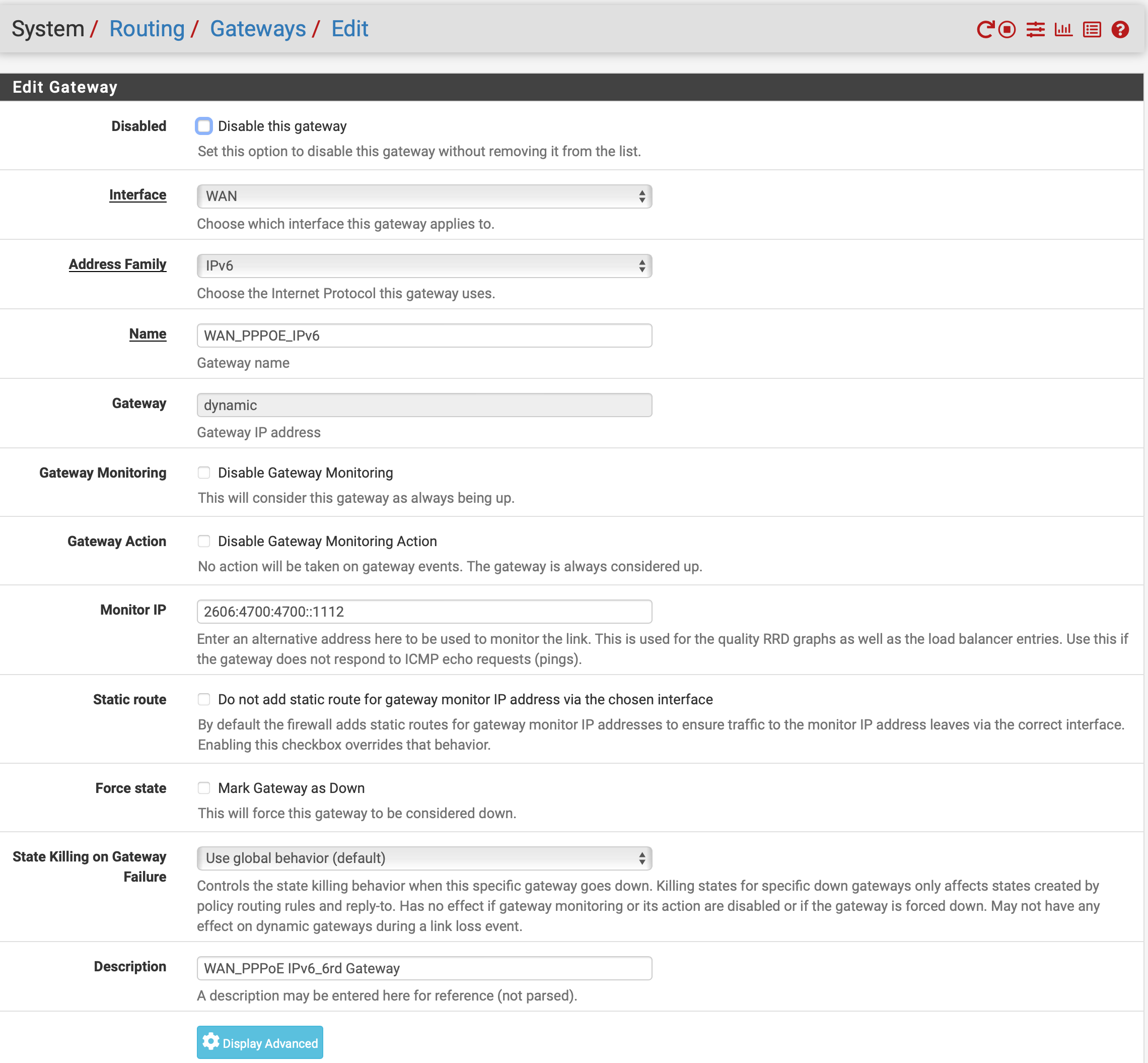

      Firewall Rules for WAN and VLAN along with Gateway below:
      Any advice to allow IPv6 on the VLAN without bouncing the interface would be greatly appreciated.
