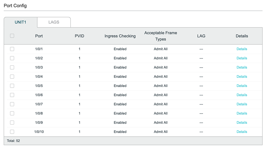

      Yes, all the ports on the switch are set to PVID 1:
      The table is scrollable, and when I scroll down PVID = 1 for all of the switch ports.

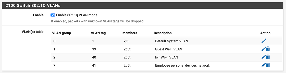

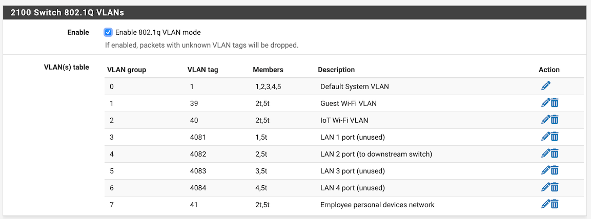

      This is my new configuration in Interfaces → Switch → VLANs now looks like this:

          @DominikHoffmann said in What is wrong with this 2100 switch configuration?:
          I configured my MacBook Pro’s Belkin USB-C to Ethernet adapter to untag traffic with VLAN ID 39 and hooked it up to Switch Port 2 on the 2100 directly.
          Now the switch config does indeed look good.

            Ok that 2100 switch config should work for a directly connected connected tagged client like that.
