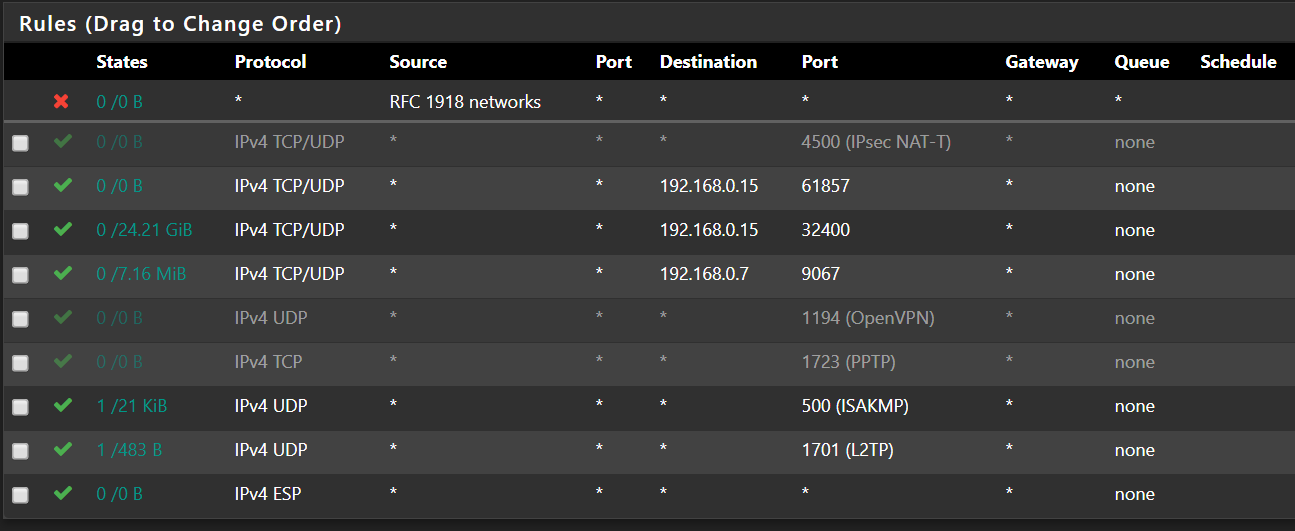

  • Setting up ipsec on wan routed subnet
    417 Views
    DerelictD
    IPsec requires: UDP 500 UDP 4500 Protocol ESP You might or might not need protocol ESP based on NAT Traversal. Probably just want to post your NAT settings and WAN rules.
