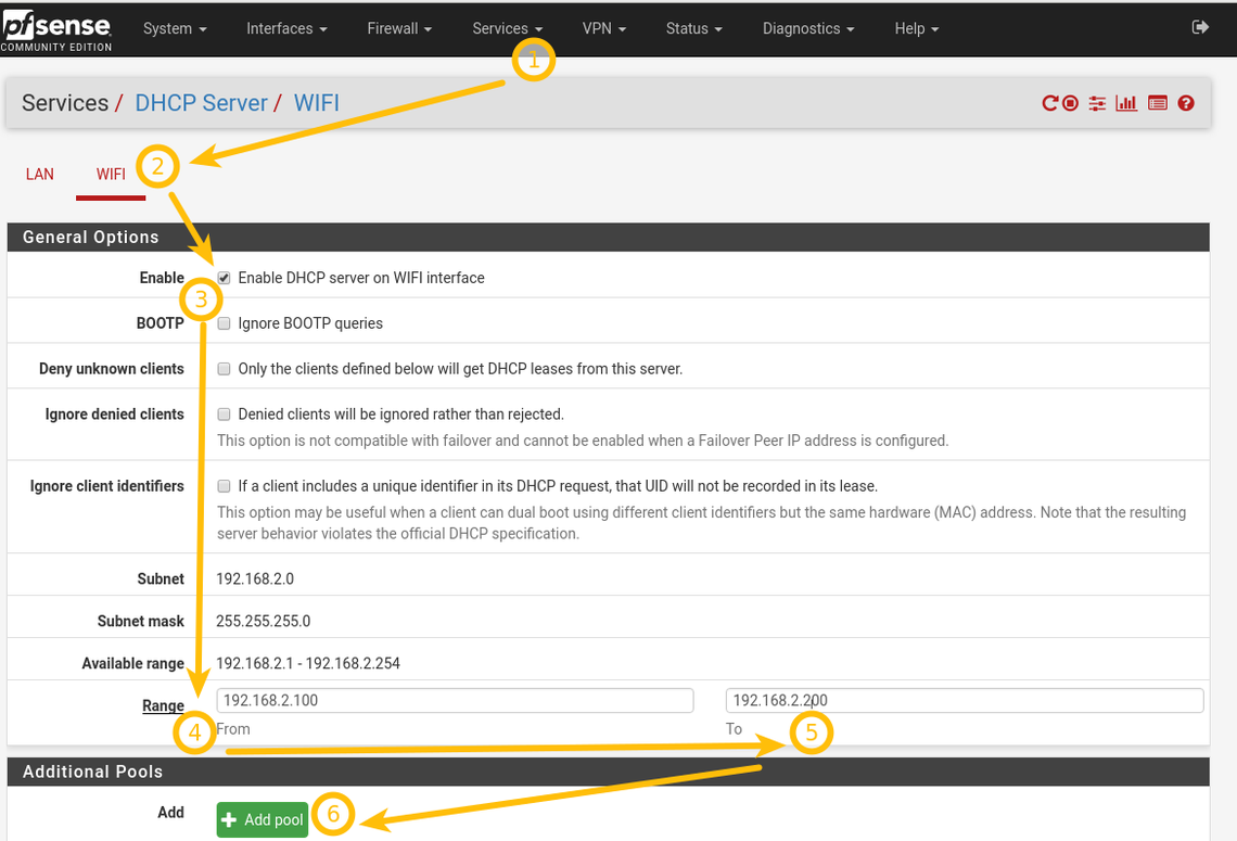

  • DHCP Server on pfSense for L3 Switch doing InterVLAN Routing
    567 Views
    JKnottJ
    @sebwelch said in DHCP Server on pfSense for L3 Switch doing InterVLAN Routing: So pfSense can have DHCP Scopes even though it doesn't have a physical interface with that range? If the routing is done elsewhere, you need a relay agent. If the routing is done with pfSense, then it can directly access the networks and provide DHCP directly.

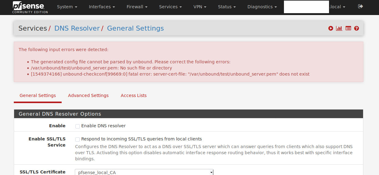

  • unbound services crashes with certificate/file not found error
    RonpfSR
    https://forum.netgate.com/topic/106011/solved-pfblockerng-reloading-unbound-fails/10 https://forum.netgate.com/topic/140262/solved-new-sg-1100-dns-resolver-not-working

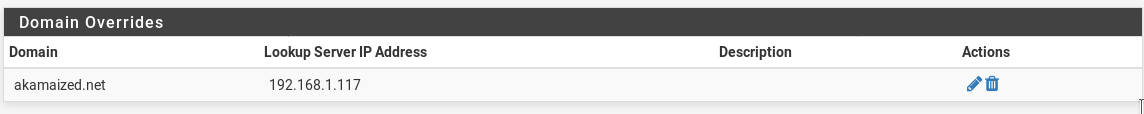

  • Domain override funny behaviour
    250 Views
    RicoR
    Now I want to know what is funny about it. -Rico
