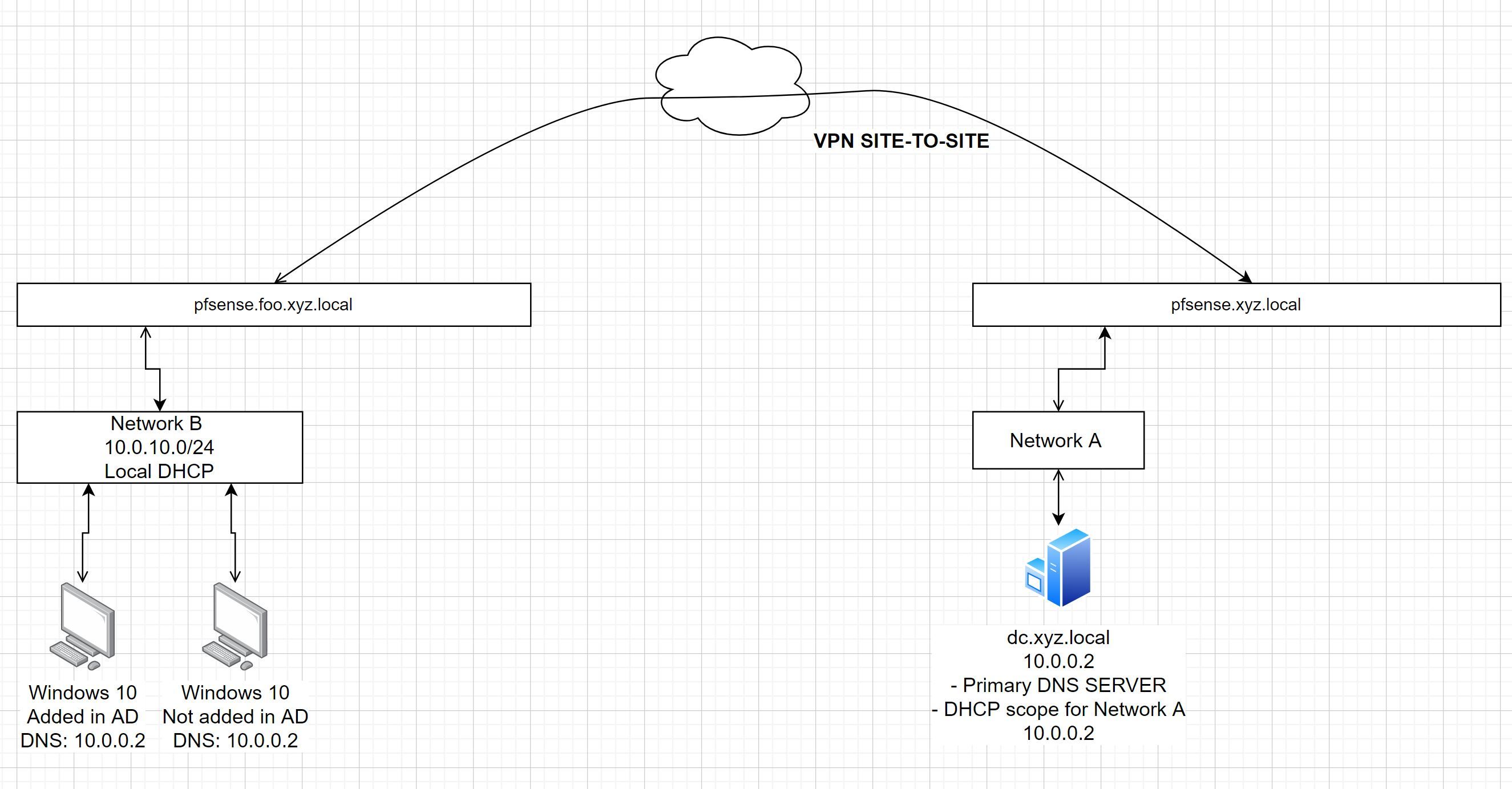

    SipriusPTS
    So, the way that I have found to solve this the best way, was to keep that DHCP on Network B and a subdomain there as foo.xyz.com, as a stand alone, and forward all xyz.com to my dc.xyz.com DNS server. The problem that I am still trying to solve is that forwarding queries from my dc.xyz.com to pfsense.foo.xyz.com, are not being solved or even queried. Even the 10.0.10.1 is not solved and gaves the error message in validaded: the server with the IP address is not authoritative for the required zone. I've delegated that subdomain foo.xyz.com to 10.0.10.1 DNS server who is the pfsense.foo.xyz.com. In my dc.xyz.com I have the following: [image: 1618562269385-screenshot_622.jpg] But testing from a stand alone pc in the same network of my dc.xyz.com, I am able to use the pfsense.foo.xyz.com as a DNS server. Anyone here knows if I am missing some step or steps to be able to perform this setup?
