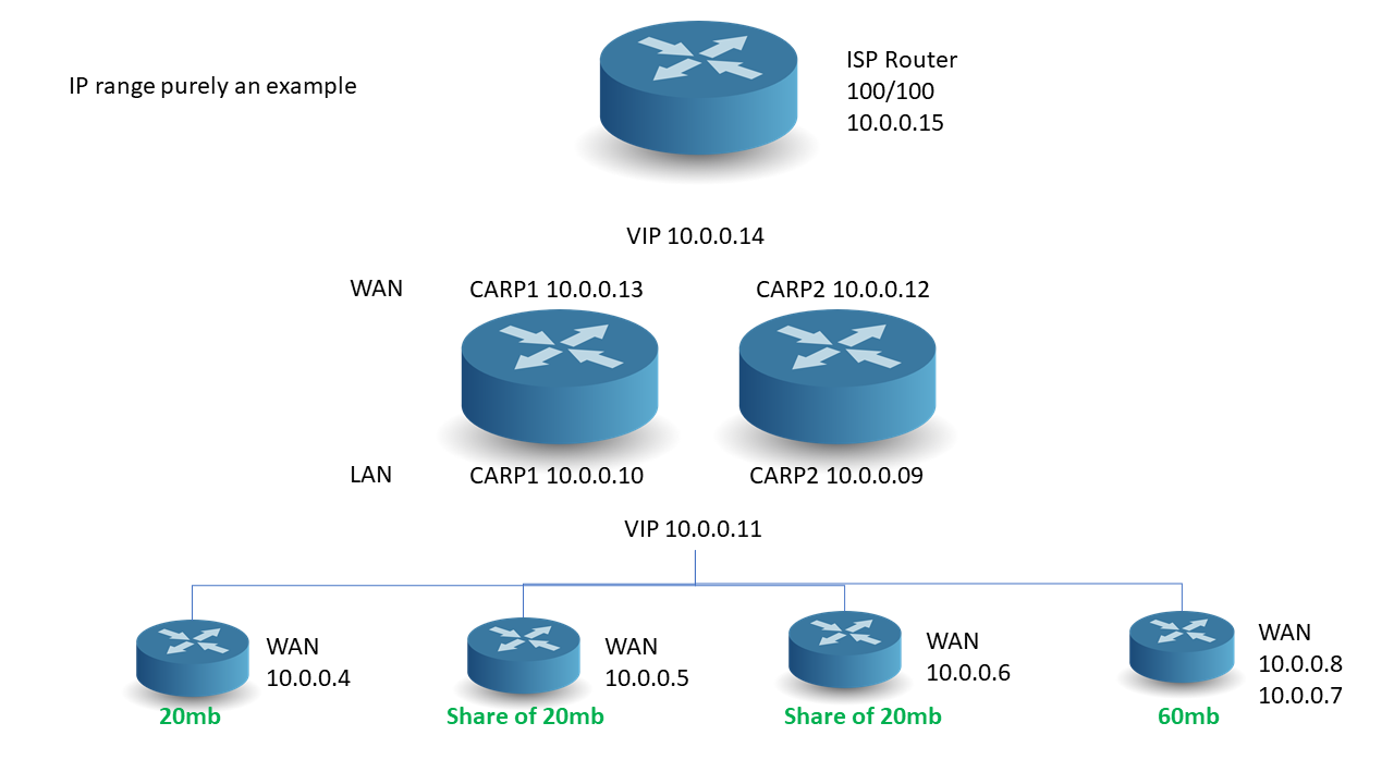

  • Sharing ethernet line with dedicated pipe for each company
    506 Views
    Yeah why not just use 1 pfsense, put your different companies on different networks and then just limit bandwidth or better just rate limit them at the switch level.
