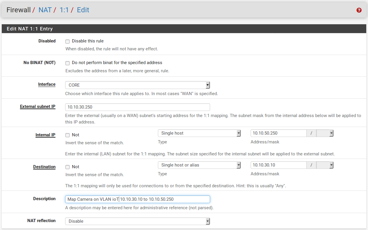

    428 Views
    You only need an outbound NAT rule for that. Firewall > NAT > Outbound If your outbound NAT is in automatic mode switch to hybrid first. Then add a rule: Interface: IoT Destination: 10.10.30.10 (the cam) Translation address: Interface address. Rules to allow access have to to be add to the interface where the connections come into pfSense, here it is the core.
