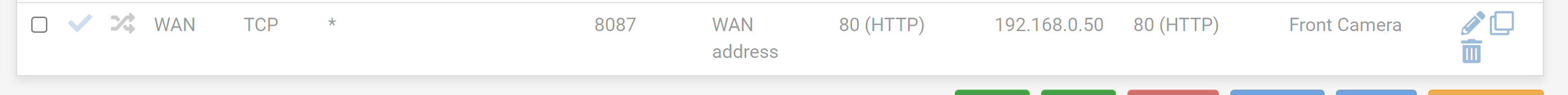

  • Port Forwarding From Port to Different Port, i.e. port 8087 to port 80
    @johnpoz Yep! I've got a headache!! But I am understanding a LOT more. Again, thank-you!! You sir are awesome! John
