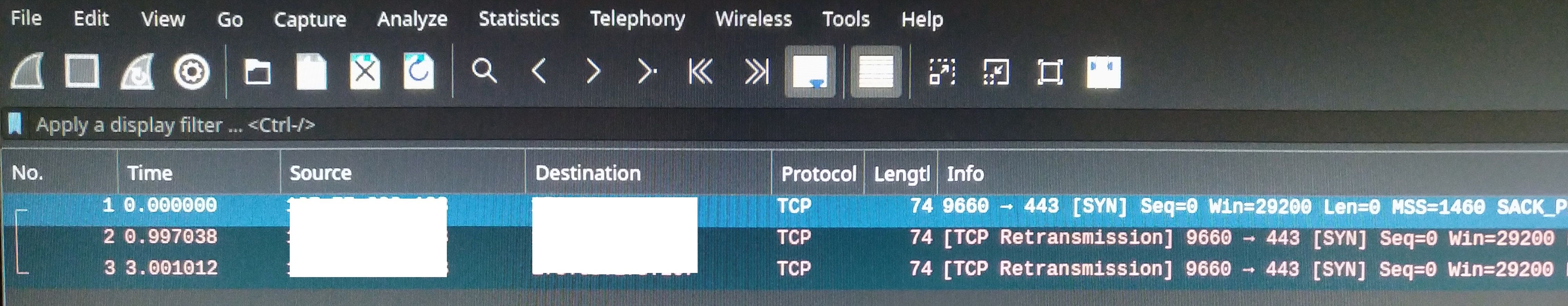

    E
    Disregard post, problem is unrelated to nat. Web server private IP was banned by pfsense.
