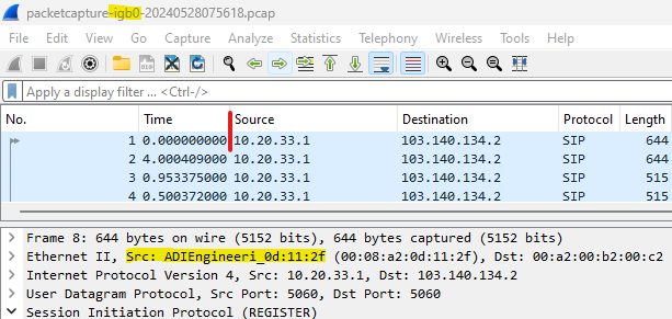

  • Yealink Phones will not register to cloud PBX behind pfense
    651 Views
    planedropP
    I definitely haven't ever had issues registering Yealinks phones, we aren't using FreePBX though, I think maybe change the post title to be about 3CX? Doesn't sound like a Yealink specific issue to me. As for why it worked on the Sonicwall, this is one of the reasons I don't like sonicwall and most other "enterprise" firewalls, they do too much for you "automagically" so then when things don't work it's hard to know why; since we can't always know why it worked in the first place lol. Anyway, anti-Sonicwall rant over. So some devices register fine, do they make calls OK or just register? Same subnet and all that I presume? If you do a pcap, can you see the Yealinks trying to reach out on 5060 and just not getting a response?
