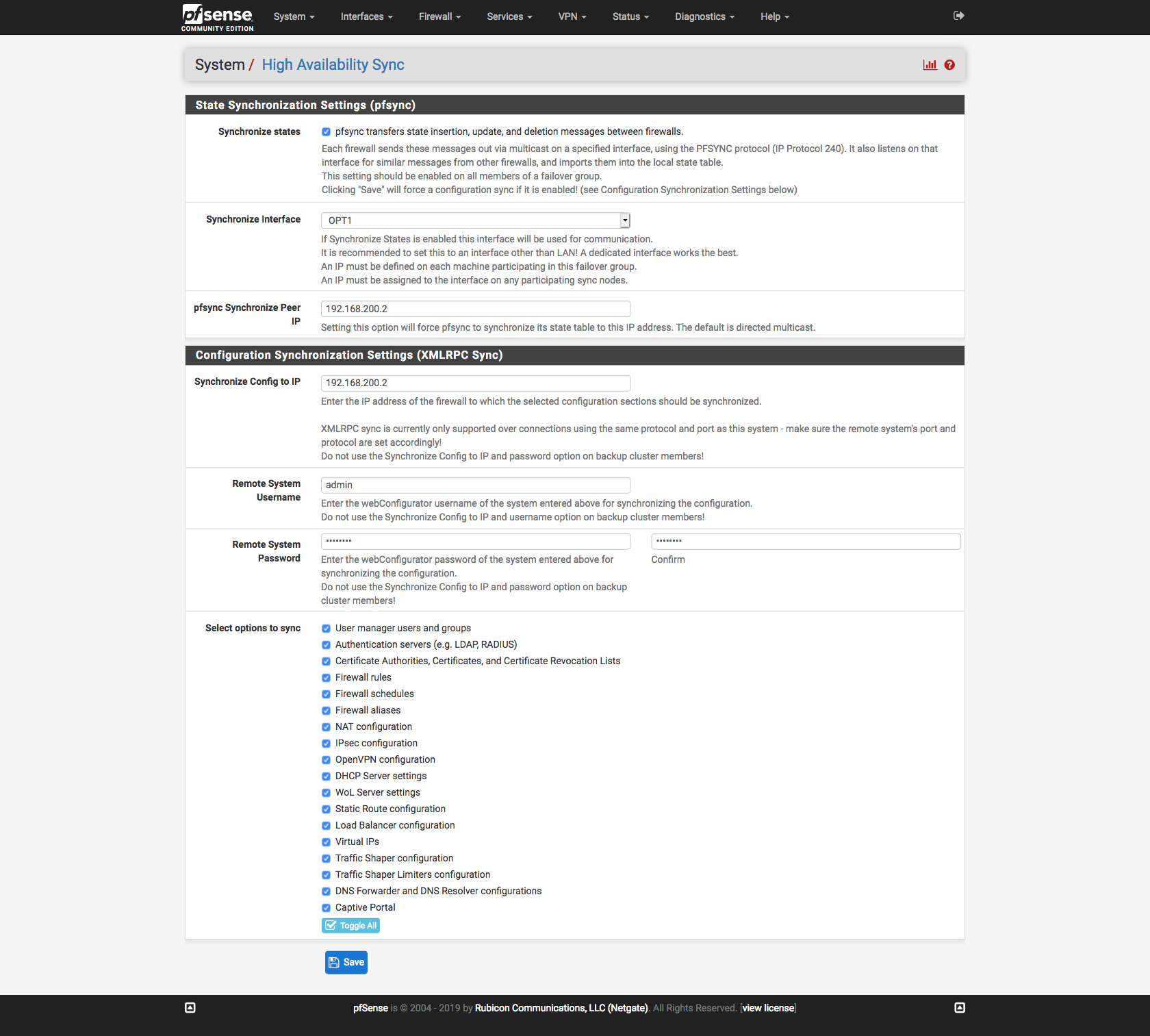

  • No single point of failure- pfsense HA
    Hello Derelict. finally i was able to solve the problem due to the misconfigured XMLRPC SYNC section : the two pfsense had different password to admin username . in addition , in one of the servers the ip address in XMLRPC field was blank thanks for your willing to help me with this issue
