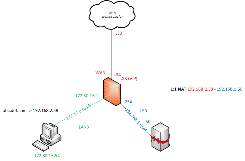

  • LAN clients - how to access service located on WAN VIP internally
    391 Views
    Why would you not just resolve abc.def.com to 192.168.1.50 in the first place for devices behind pfsense...
