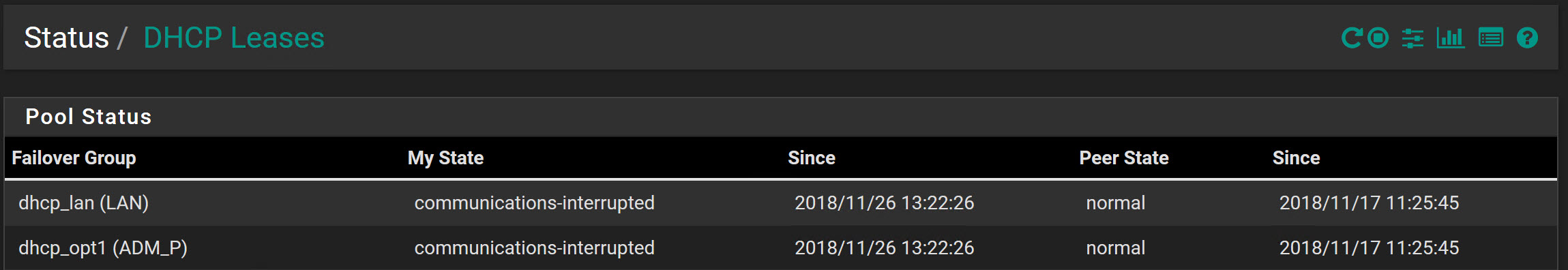

  • communications-interrupted in Failover group
    X
    @derelict Sorry because my HA interface is a VLAN I forgot to added into the switch That was the problem Thank you
