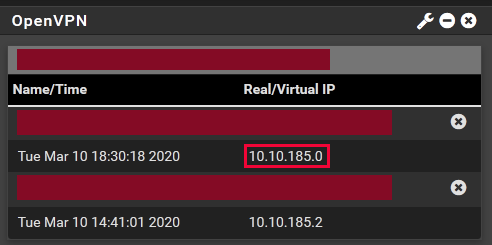

    20
    20 Posts
    @johnpoz I followed the instructions but after a couple of days the problem is present again, the vpn client has been assigned the IP address: 10.0.2.3 how is it possible ? where am i wrong? thanks.
