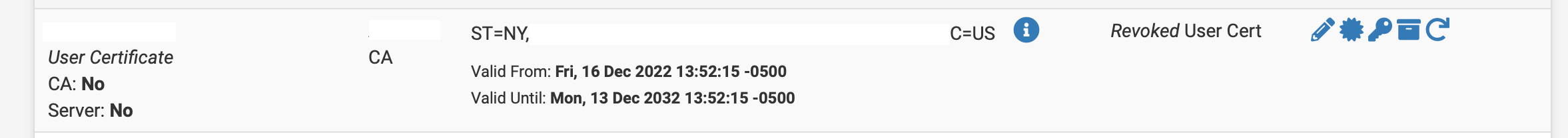

  • User cert revoked by itself.
    786 Views
    @jimp thanks a lot, this is exactly my case. Cheers!
