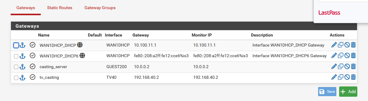

  • static routes - via firewall rules - phillips casting sever
    166 Views
    By having the casting server act as a separate router between the two subnets you are creating an asymmetric route at both ends. I would expect TCP traffic to fail and see blocks in the firewall log? Unless you have added workaround rules to allow it. https://docs.netgate.com/pfsense/en/latest/troubleshooting/asymmetric-routing.html That would happen with any type of routing.
