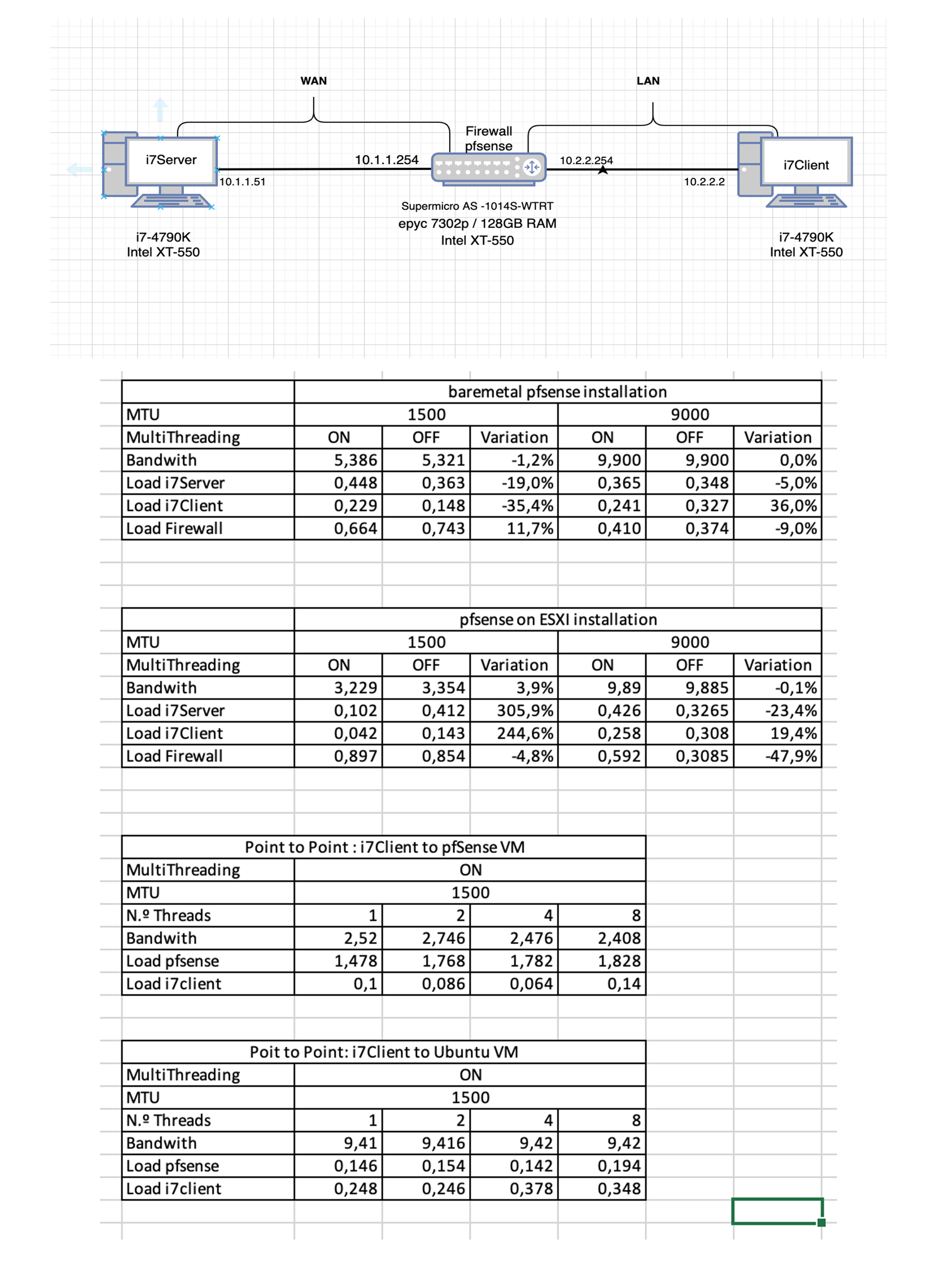

  • Poor pfSense benchmarking performance, any guesses why ?
    976 Views
    Right, so in the 3rd table you are using pfSense as one side of the iperf test directly. That will always give a bad result.
