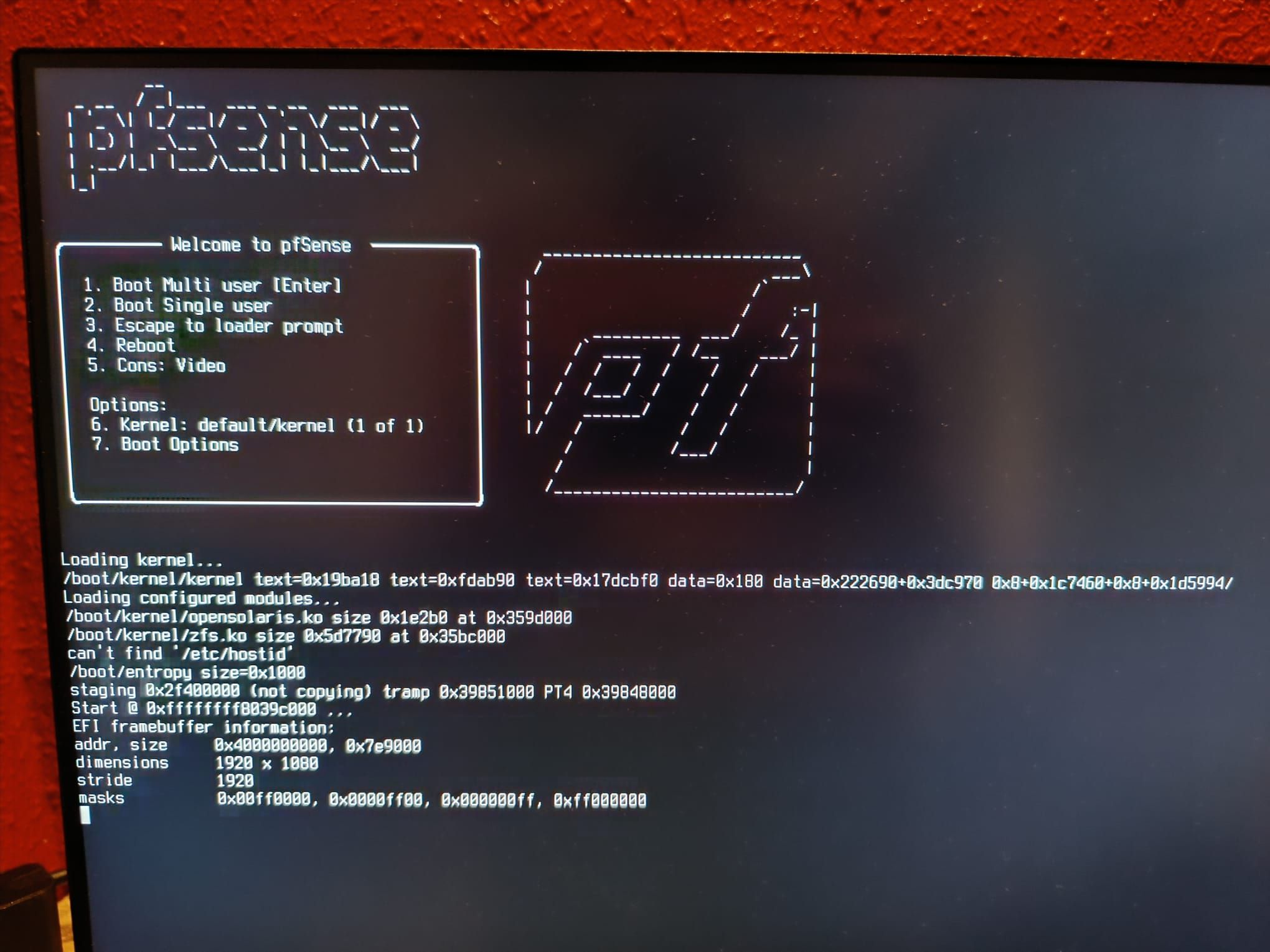

    @stephenw10 I just resorted to using opnSense, WiFi interface is detected straight out of the box through iwlwifi (It's FreeBSD 14) and no weird boot problems thus far. Thank you for the quick response, but I believe I might need some missing software/drivers or tweak the configuration accordingly, and I'm not getting much information on what's missing either, so I'm not going through that unnecessary rabbit hole.
