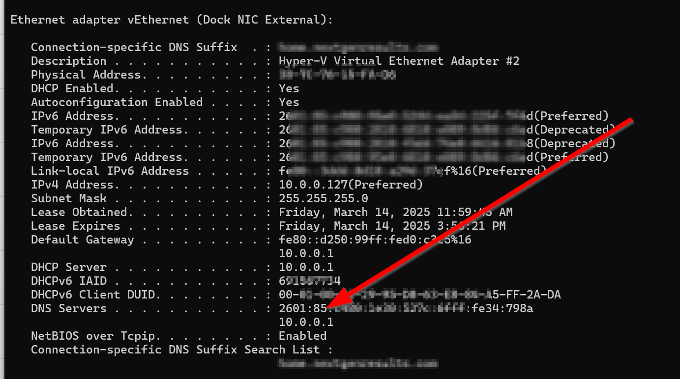

    @Bob-Dig That's very Interesting, oddly though, the client with 0 issues is also the client with the extra stale ipv6 addresses. I found some info on some MS forms that suggests Windows has an issue when the NIC is using both IPV4 DHCP and IPV6 RA at the same time. i.e. other have seen similar DNS weirdness. On the broken system I just tried disabling IVP4 TCP/IP and after rebooting that same box now receives an IPV6 DNS Server. If I then re-enable TCP/IPV4 on the nic, that same system wipes out the DNS servers and replaces with only an IPV4 value. So this is really starting to feel like a pure MS bug, I don't see how the above could be influenced by PFSense.
