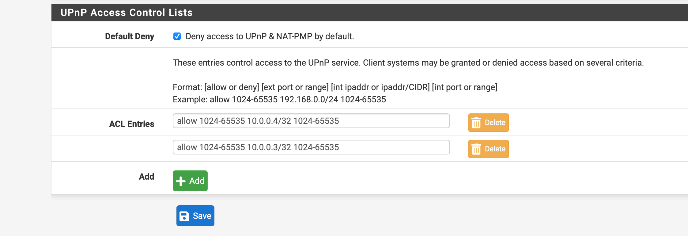

  • UPnP& NAT-PMP IPv6 ACL?
    309 Views
    jimpJ
    No, there isn't. miniupnpd itself doesn't support IPv6 ACLs. https://github.com/miniupnp/miniupnp/issues/694
