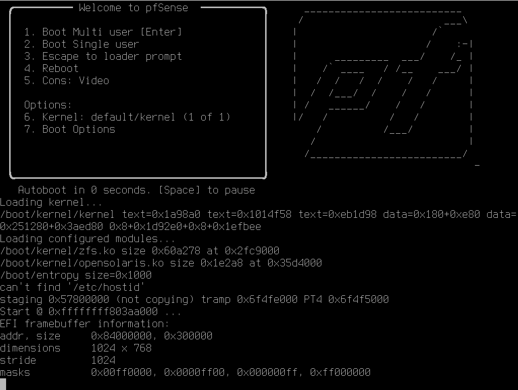

  • pfSense CE 2.8.0 upgrade stalls after reboot and gets stuck in Stage 2
    155
    155 Posts
    33k Views
    patient0P
    @andres-asm if I read it correctly you're running pfSense in a VM on Proxmox (8 or 9?) with EFI. What 'Machine' are you using on Proxmox, 'Default (i440fx) or 'q35'? There is a thread about issues with pfSense running on Proxmox with UEFI: After upgrade 24.03 to 24.11 reboot hangs at start @ 0xffffff..... The root cause is not yet known.
