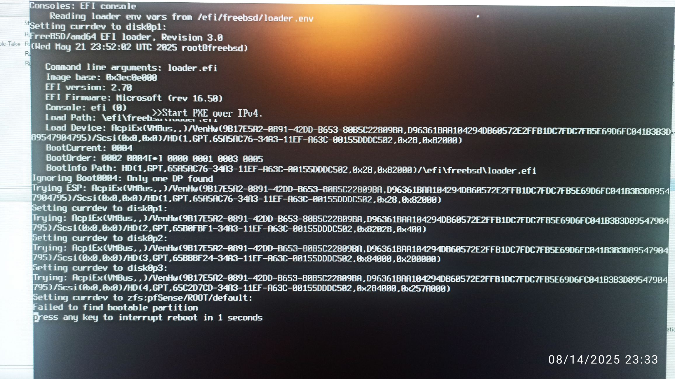

  • pfSense won't boot after upgrading from 2.7.2 to 2.8.0.
    That's a bios or efi function. It deppends how the BIOS presents it. If it boots pfSense you can use efibootmgr to set the boot order if you need to.
