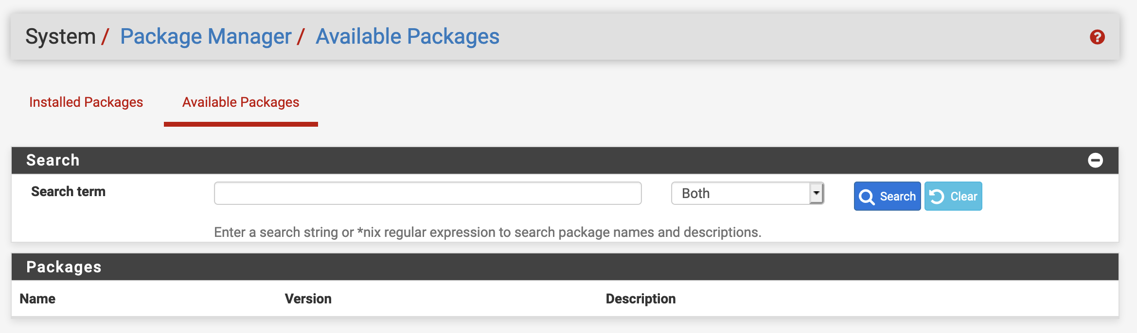

  • Can't update packages on 2.4.5
    GertjanG
    To be sure : look up all the 'snort' and 'squid' posts from the last 2 weeks or so. You'll find a way to put things back in track.
