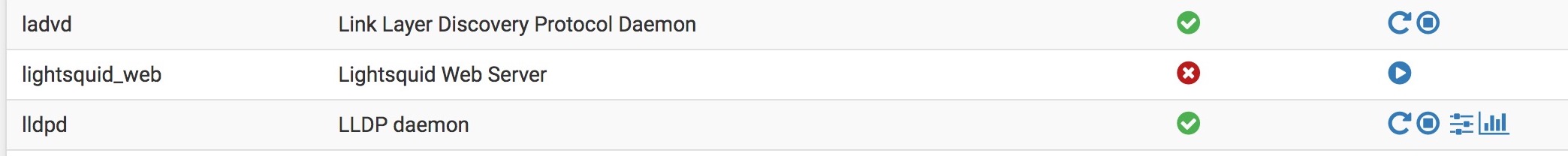

  • Lightsquid not removed properly, I think....
    543 Views
    occamsrazorO
    @jimp said in Lightsquid not removed properly, I think....: Install lightsquid again and then uninstall it, which should remove its service tags Thank you! That worked.....
