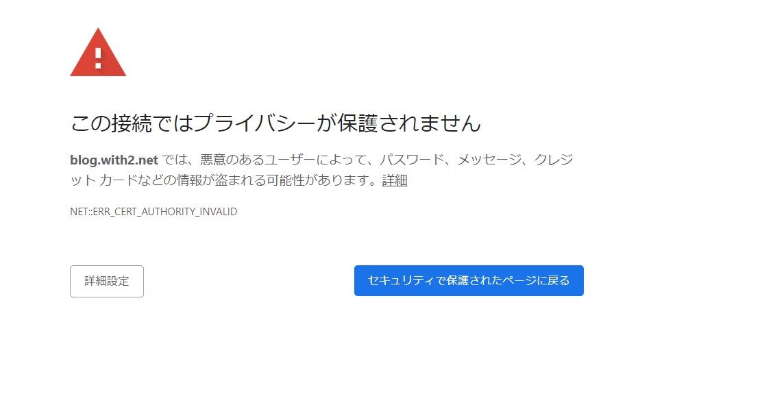

  • "Your connection is not private" issue
    968 Views
    N
    @netboy Another observation... I connect my iphone to wifi 172 subnet. Type https://www.cnn.com get "your connection is not private"... Turn off wifi and use the data plan that comes with my phone Connect to https://www.cnn.com connects like a charm I am going to assume this has something to do with my pfsense router....100% Now I connect my iphone to wifi 192 subnet and it works like a charm.. Remember I have made ZERO changes to my router I am happy to troubleshoot if somebody can help me I "disabled" pfblockerNG and I get the same symptoms...So it appears it has to do with pfsense rather than pfblockerNG? Not sure SOLVED!! Nothing to do with pfsense.....I had a wifi repeater for 172 network...(nokia router in bridge mode) - rebooted it and everything worked fine...... Close this thread please
