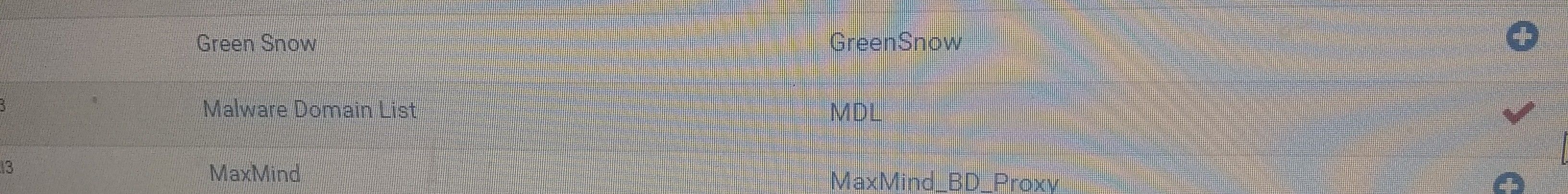

    @bambos Hi, I would suggest you start with the set up wizard for pfBlocker-NG-devel. The learning curve for pf bocker can be steep, so go slow and read everything......twice. In addition, go to the help on your pfSense dashboard, then click pf Sense book and navagate to pf blocker package and read up. just type pf blocker in the search of the book.This will give you a good start and basic understanding.[image: 1645549741940-screenshot-from-2022-02-22-08-46-26.png][image: 1645549879322-screenshot-from-2022-02-22-09-10-59.png]
