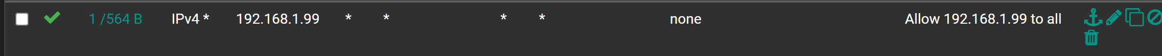

    @wintok what specific brother do you have? I have brother on a different vlan and have no issues printing to it. The specific rule is not needed that is for sure.. What is the full order of you rules? Do you have any rules in floating? If you can access the web gui, but not print - that pretty much points to those ports not involved? Or are you trying to find the printer via airprint or some discovery that doesn't work across vlans? If you know the IP of the printer, just setup your print driver to directly point to that IP. [image: 1686625683101-printer.jpg]
