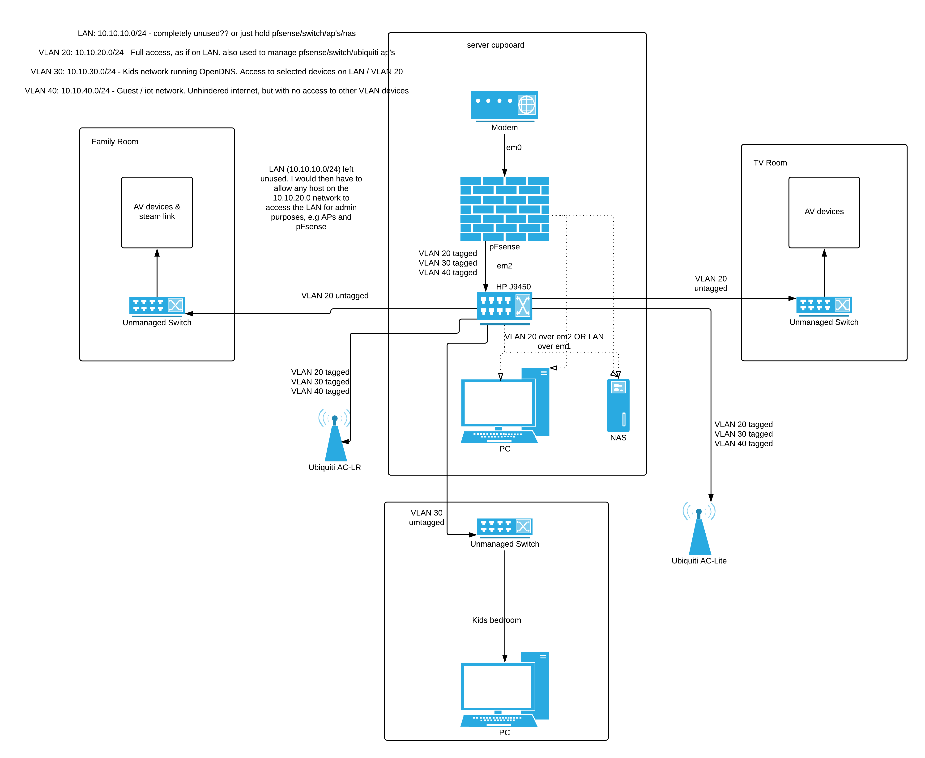

  • pfSense, HP J9450, Ubiquiti AP's
    506 Views

  • Default VLAN behaviour
    DerelictD
    To the firewall, an untagged interface and a VLAN interface are the same thing. The both need firewall rules to block or pass traffic into that interface (physical/untagged or virtual/tagged).
