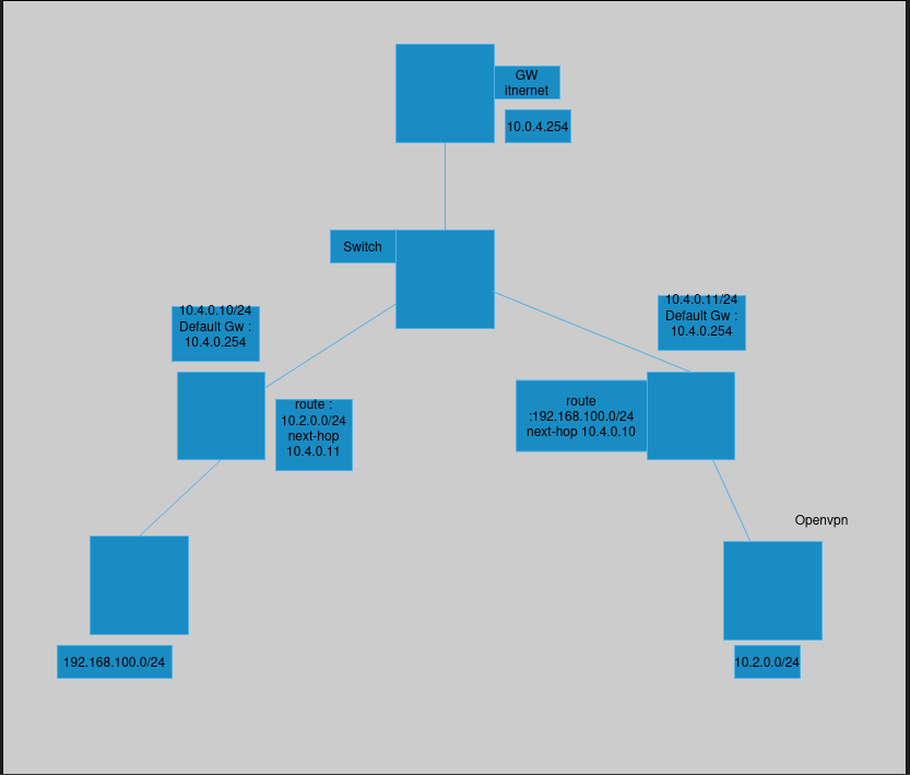

  • static are not used when trying to communicate between 2 pfsense CE
    370 Views
    U
    Ok I tried your solution, and it's ok. Really thank you, for the solution and for the explaination. I really don't like doing thing without understanding what I'm doing and why. One more time Thank you
