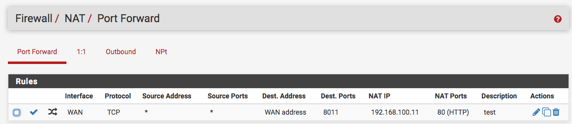

        I am trying to port forward to my IP Cameras web admin. Here are screenshots of Rules and DIagnostics.
        NAT rules
        Firewall rules
        Ping from LAN
        Ping from WAN

          What port does your camera use, you have 8011 in the nat section and 80 in the firewall rules.

                                      BTW your rules are WRONG... Just let your port forward create the rules...
                                      They should look like this..
                                      Why do you have that 8007 rule to any in there?
