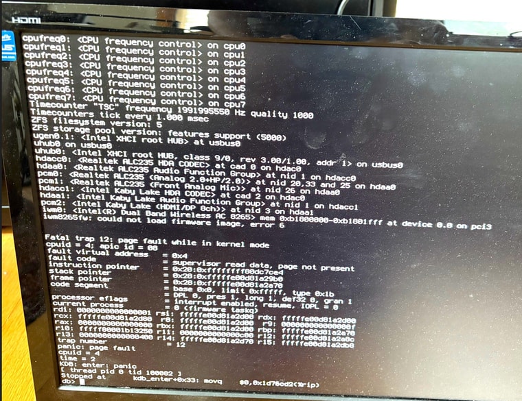

                                  Spacecase
                                  I just ran into the same issue with the release version. Update went smoothly until it didn't. It presents the same modality and fault codes, but different addresses and hardware details.
                                  I reverted back to 2.7.2.
                                    stewartv8 @stephenw10
                                    @stephenw10 good news i pulled the card from the server unplugged the keyboard while updateing and all went well. Now on the latest ver thanks for ya help :)
                                      stephenw10 Netgate Administrator @Spacecase
                                      @Spacecase said in Kernel Panic when Upgrading to 2.8.0 beta:
                                      Could be a very different panic then. Do you have the details? Did the console also become unresponsive?
                                        Spacecase @stephenw10
                                        When updating from v2.7.2, all looked well until the reboot. The dashboard was still in a 20s loop. At the time, I had no monitor on the console, but it was dark when I connected it. I rebooted the host and, if I recall correctly, there was still nothing on the screen. At that point, I used the installer and could see boot activity on the console.
                                        Here's the screenshot:
                                        It's looking for the WiFi driver.
