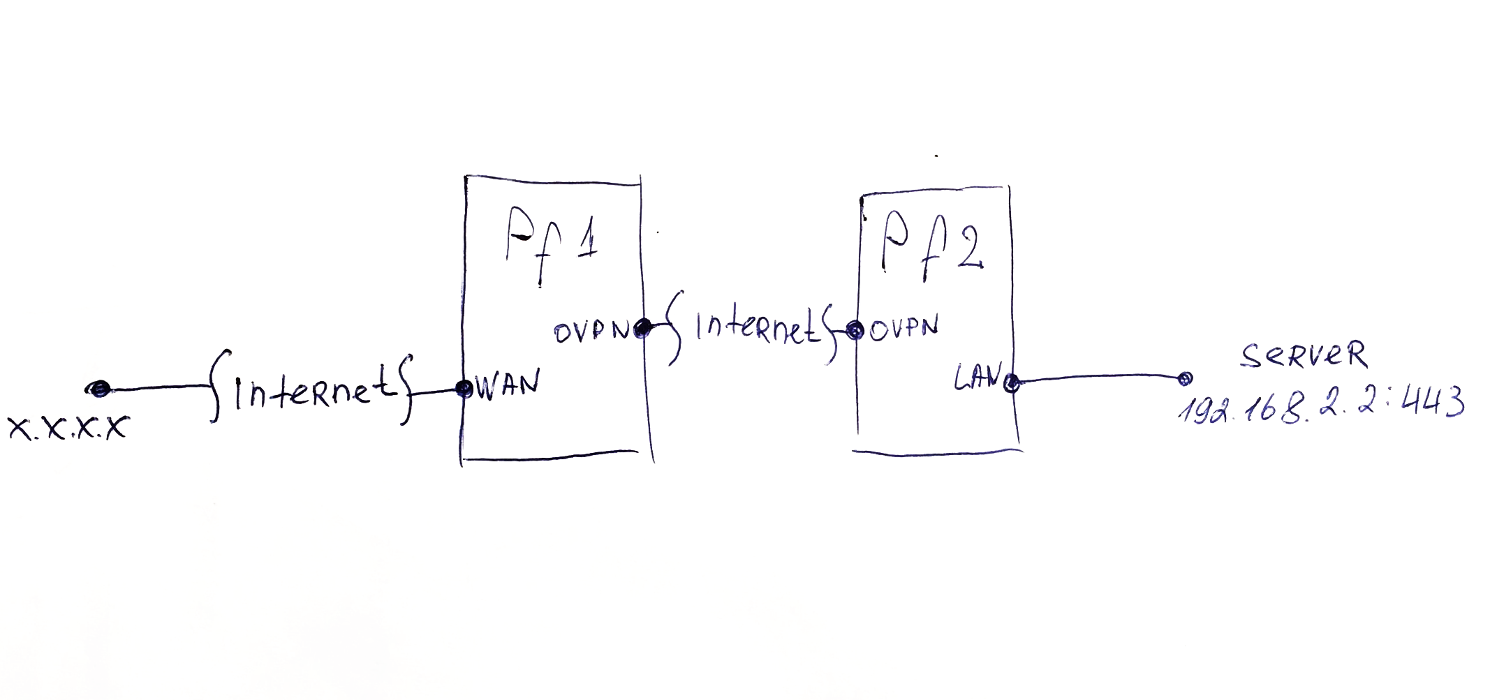

  • Trafic Redirect
    314 Views
    That's straight forward. I had made such forwardings several times. Ensure that Pf2 is the default gateway for the server and that a firewall rule on the specified OpenVPN interface is allowing the access and that it matches. Also on Pf1 WAN you need a rule allowing the traffic, of course. @Ilya-V said in Trafic Redirect: added a permissive rule for everything You have to ensure that there is no rule on the OpenVPN tab which matches the traffic. OpenVPN is an interface group including all OpenVPN instances you're running and it doesn't work on interface groups! That's why I wrote "move the rule from OpenVPN...".
