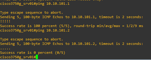

    It is stange but ping appeared after 5 minutes from last pinging try. [image: 1609586274643-shooterscreenshot-29-02-01-21.png]
