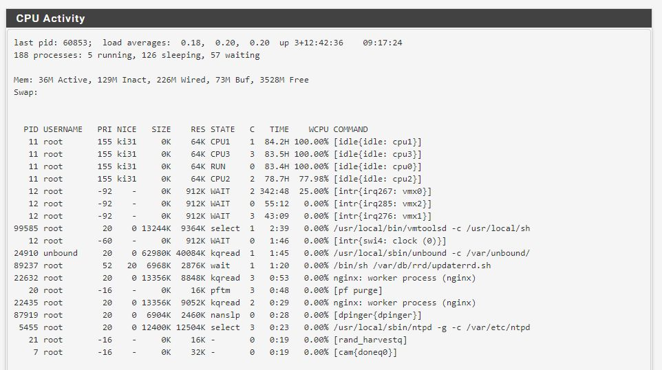

  • Loving pfSense in my vSphere environment, but...high CPU...
    13
    13 Posts
    Ok - Naked FreeBSD 11 on esxi 6.7u2 with i350 t4 in pci passthrough -> iperf 1Gbit = 80% CPU load on a 3.9 Ghz i3 7100 cpu Naked FreeBSD 12 on esxi 6.7u2 with i350 t4 in pci passthrough -> iperf 1Gbit = 6% CPU load on a 3.9 Ghz i3 7100 cpu Edit - seems like the host cpu ramps up to 80% on freebsd 12 and 11 when i run 1 Gbit through the vms... the vms show only 12% cpu load inside (htop). Guess its just how freebsd handles packets... a debian vm shows 12% host load and 8% vm load when im iperfing...
