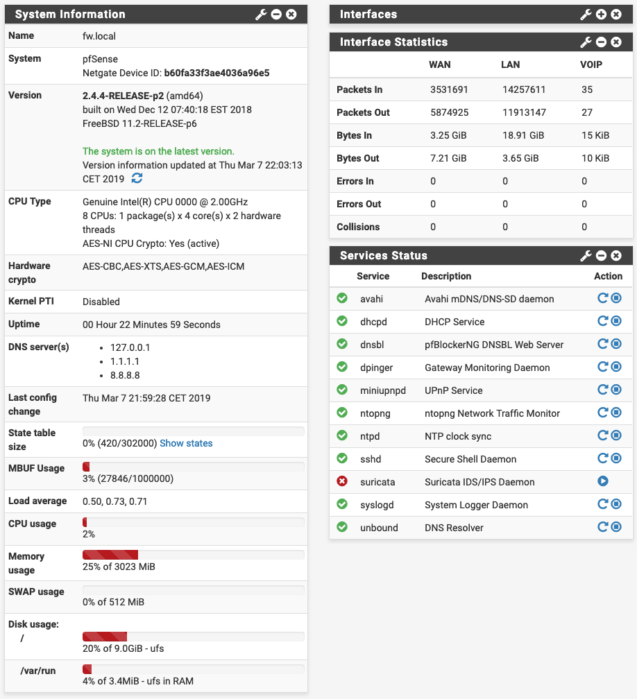

  • Passthrough Intel Pro/1000 with ntopng only 500 Mbits/s
    870 Views
    Used 4000000 but I'm unable to improve it further. I honestly don't know what I should tweak or what's going on. On this image below, orange arrow shows when I downloaded the file from the pfSense VM. Green arrow shows when I used my server (where pfSense is running) [image: 1552041054856-screen-shot-2019-03-08-at-11.30.00.png] EDIT: Adding a video where you can see how it looks downloading from pfSense vs server (both connected with LAN). Looks like the pfSense is being limited to around 250mb? while the server can download at more speed for a limited amount of time. This is driving me crazy haha Video: https://d.pr/v/1OYQeP
