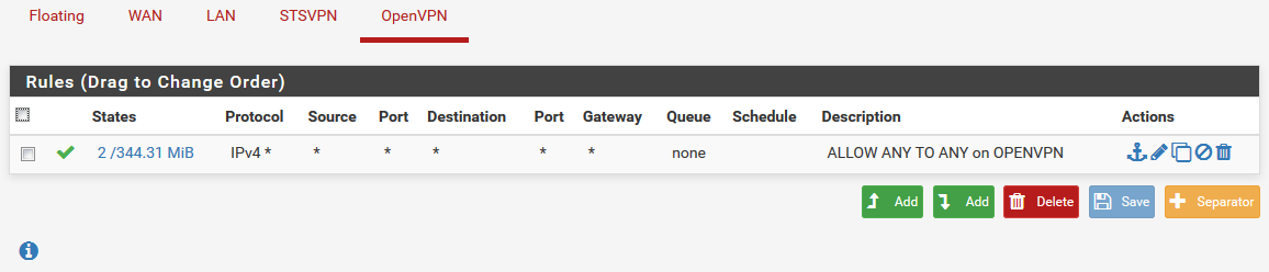

    Hey. I don't understand the problem, why he won't go out with the ping over the vpn tunnel. My settings for OvpnServer: [image: 1540368232065-2018-10-24_095723-resized.png] [image: 1540368266943-2018-10-24_095758-resized.png] [image: 1540368275037-2018-10-24_095816-resized.png] My Firewallrules: [image: 1540368289820-2018-10-24_095837-resized.png] My Interfaces: [image: 1540368310210-2018-10-24_095911-resized.png] My Interface setting OPT6: [image: 1540368336437-2018-10-24_095928-resized.png] My Gateway OPT6: [image: 1540368371948-2018-10-24_095959-resized.png] My static route: [image: 1540368404891-2018-10-24_100028-resized.png] I take a traceroute to destination 192.168.3.32 over my local LAN Interface: [image: 1540368588241-2018-10-24_100905-resized.png] I've only see this: 1 10.2.28.1 0.240 ms 3.165 ms 0.200 ms 2 10.2.28.1 3.687 ms 3.664 ms 0.228 ms 3 10.2.28.1 3.593 ms 3.703 ms 0.244 ms 4 10.2.28.1 3.639 ms 3.698 ms 0.241 ms 5 10.2.28.1 3.650 ms 3.765 ms 0.254 ms 6 10.2.28.1 0.260 ms 0.238 ms 3.648 ms 7 10.2.28.1 3.676 ms 0.257 ms 3.640 ms 8 10.2.28.1 3.711 ms 0.270 ms 0.270 ms 9 10.2.28.1 0.286 ms 0.277 ms 0.286 ms 10 10.2.28.1 0.288 ms 0.248 ms 3.631 ms 11 10.2.28.1 3.826 ms 0.283 ms 3.729 ms 12 10.2.28.1 3.736 ms 0.289 ms 3.544 ms 13 10.2.28.1 3.830 ms 0.314 ms 0.297 ms 14 10.2.28.1 0.309 ms 0.365 ms 0.311 ms 15 10.2.28.1 0.318 ms 0.315 ms 0.316 ms 16 10.2.28.1 0.328 ms 0.323 ms 0.321 ms 17 10.2.28.1 0.319 ms 0.325 ms 0.339 ms 18 10.2.28.1 0.326 ms 0.331 ms 0.333 ms But, i can ping the virtual ip 10.2.28.1 (pfsense) to my zeroshell (foo 10.2.28.2) looks like good: PING 10.2.28.2 (10.2.28.2) from 10.2.28.1: 56 data bytes 64 bytes from 10.2.28.2: icmp_seq=0 ttl=64 time=26.396 ms 64 bytes from 10.2.28.2: icmp_seq=1 ttl=64 time=26.548 ms 64 bytes from 10.2.28.2: icmp_seq=2 ttl=64 time=26.466 ms --- 10.2.28.2 ping statistics --- 3 packets transmitted, 3 packets received, 0.0% packet loss round-trip min/avg/max/stddev = 26.396/26.470/26.548/0.062 ms Does anyone have any idea what I missed? BR
