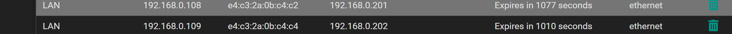

  • how do you force Hostnames to show up in the ARP Table
    854 Views
    @bob-dig thanks that worked deleting the files there in the db... after deleting it changed everything to .localdomain and then after another 10 min it renamed everything to the localhost names so i dunno why it was going crazy with the number or so.. but deleting fixed it.. i was going crazy shutting off everything refreshing clearing rebooting pfsense 3 times nothing had solved it but deleting thoses files did
