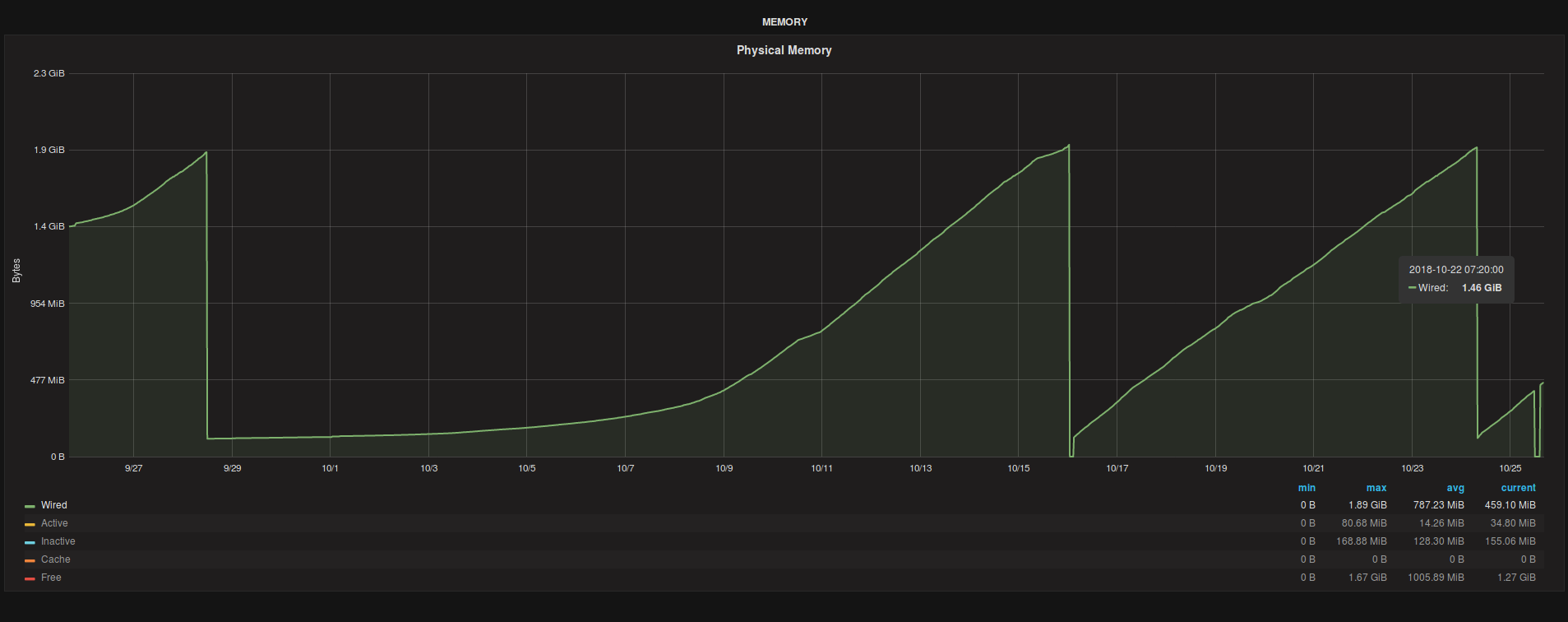

  • Allowed memory size exhausted
    13
    13 Posts
    O
    Rebooted a few times and now the error is gone but it's gotten really slow to almost not workable anymore, the router still works, however the webpages are have gotten really slow to the point where they don't load anymore.
