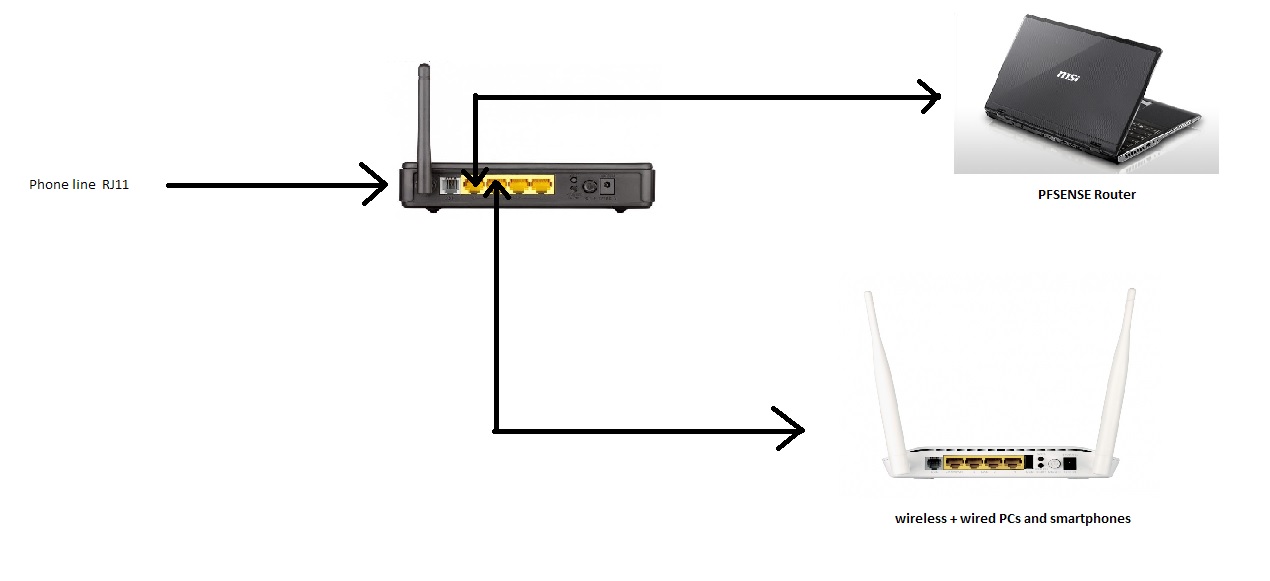

  • "Poor man" home network first try
    39
    39 Posts
    6k Views
    Thank you all for your answer. I am upgrading everything ( getting an i5-560m for AES support, ) and getting new antennas for the wifi card (because the internal antenna cables were cut (not intended) by its old owner unfortunately. I will use the Pfsense AP as a backup AP then just in case the main one does not reach (the house is not very big anyway) tomorrow cabling will be done (CAT6E , yes over overkillcables and they were so cheap for some reason and that's the only cables the guy had anyway)
