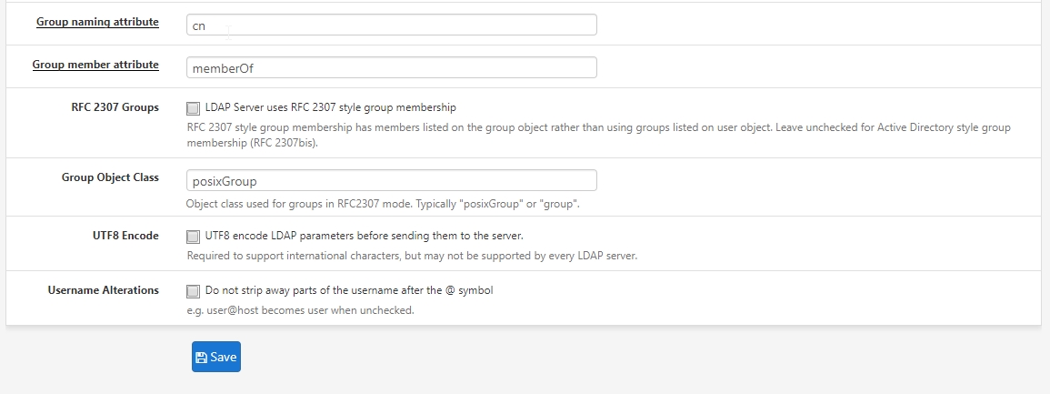

    stephenw10 - I was just saying the same thing about SSL and STARTTLS then realized you had already clarified that! In that example I gave above about the "test1" and test2" groups they were sitting side by side in the root domain which is why I don't at all understand why one works and one doesn't when my authentication container is the root domain itself. If it see's one OU it should see both right? Unless there's a way to make pfSense do a more detailed query when someone tries to log in I've about decided that this won't work. One thing I have not tried yet because it seems kind of messy to deal with later on down the road is listing each individual OU in the authentication container field. This would be easy to do since it lets you select OU's with checkboxes but if for some reason I ran into a scenario where pfSense couldn't talk to AD and I couldn't pull up that list of checkboxes it would be hell to sift through all that data in that tiny field if an OU got deleted or something screwing the whole thing up. Hopefully that makes sense.... Thanks for the responses everyone!
