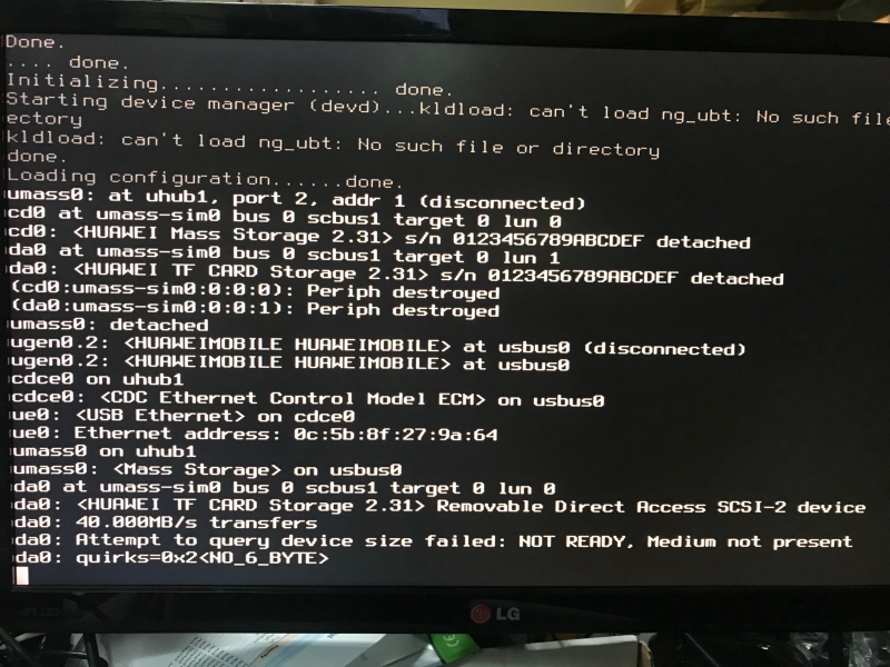

  • huawei e8372 pfsense 2.4.3
    274 Views
    Which parts of that other thread did you follow exactly? Please retail what you have done. Steve
