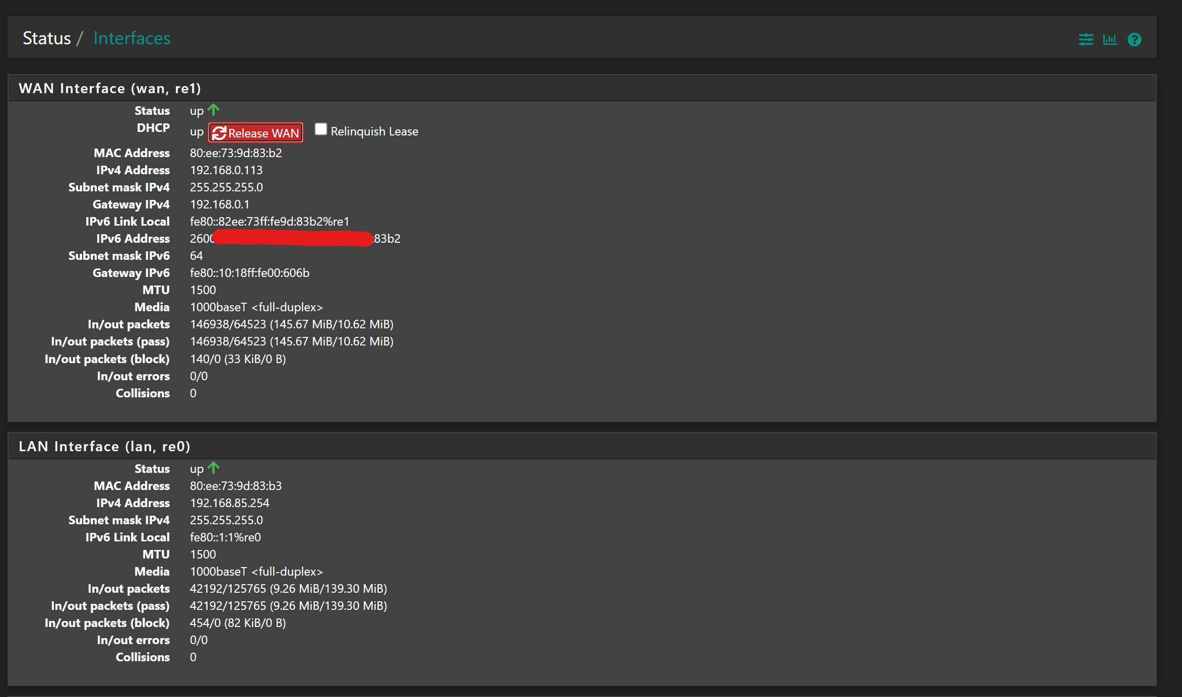

  • Troubleshooting LAN IPv6 Track Interface (Cox)
    950 Views
    ChrisLynchC
    @jknott Thank you so much for pointing that out. The presense of the 192.168.0.0/24 address should have been a clue. Stupid me didn't think of bridge mode. I was able to enable bridge mode and everything is working as expected.
