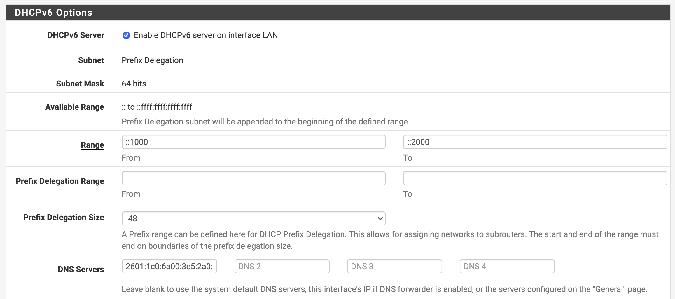

    @johnpoz Config is done and working as expected. Got a /48 from HE and /50 subnets to LAN. [image: 1597076892547-9fc6b336-5d05-4538-b512-87464720b176-image.png] DHCPv6 Server & RA (/56 to downstream CPEs) [image: 1597077968310-8466e9df-c67d-489c-a7cf-09743b7f7b14-image.png] RA [image: 1597078154820-3bffbe77-935e-49ce-b134-6c532079aa6b-image.png] Tested with Android 8/9, Android TV 7.1.2, iOS 9.3.6, Windows 10, Arch Linux, OpenWRT, and some others Home Gateways.
