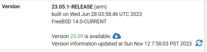

  • 3100 - Update from 23.05.1 to 23.09: Home page version Wrong
    177 Views

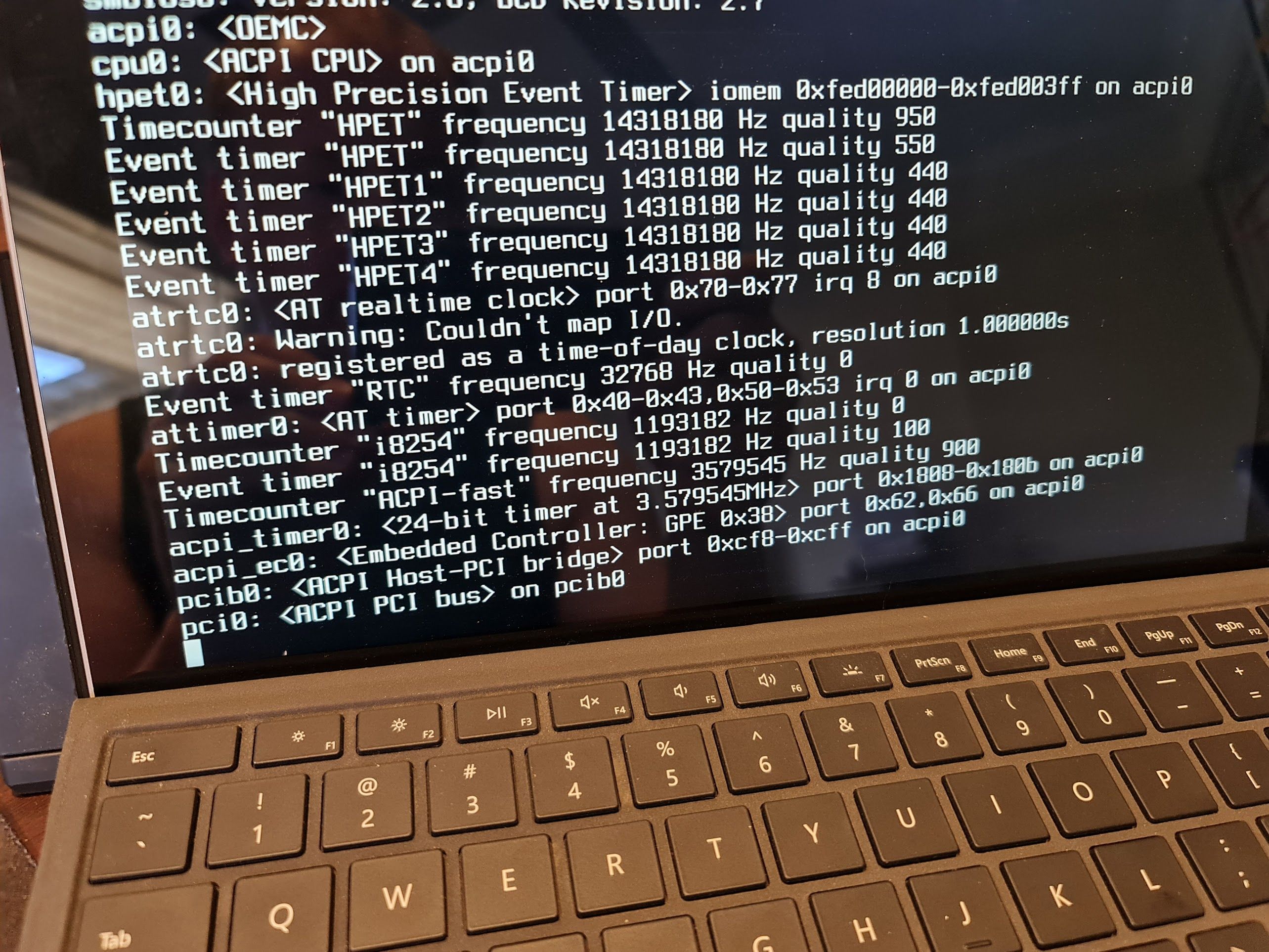

  • Crash on boot
    678 Views
    Thanks for the replies! I have a Surface pro 5 and it works on that so a Surace 3 bug I guess! Pfsense doesn't like the surface dock Ethernet port, doesn't appear as a wan/lan device. It doesn't like the surface usb Ethernet adaptor either! Same result.. I had two other usb Ethernet hubs which it's been working with so far..
