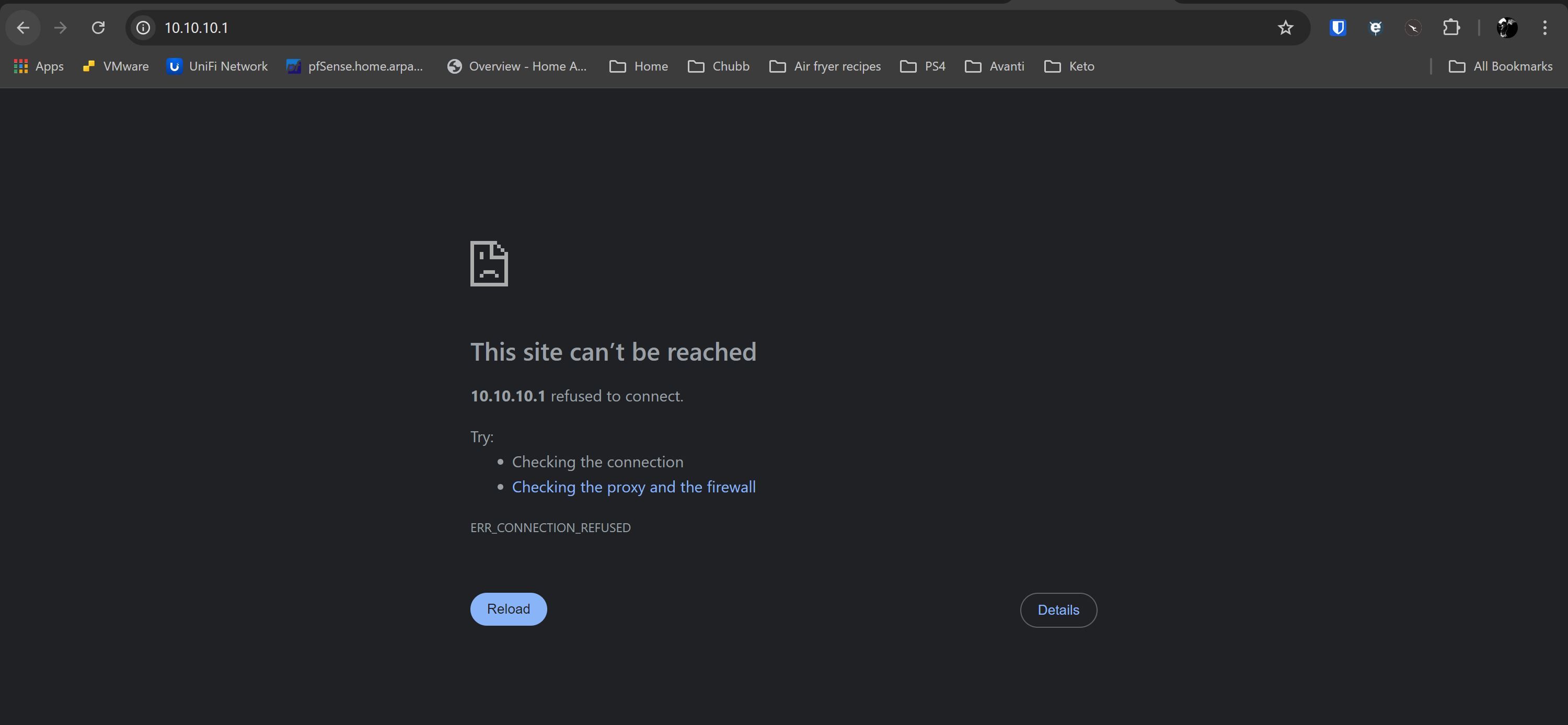

    @Gertjan Thanks for all the info :) I'll likely follow up with the point of just blocking all http traffic and call it a night.. The curious side of me just keeps on.. wireshark isn't doing much here and results are inconsistent making it hard to pin down. I have limited the scope while troubleshooting, and stayed on the default ports. I have selected only my LAN VLAN 192.168.10.x for the Web Server Interface, along with only allowing LAN for the permit/ping IP floating rules. I can see they are created and are in the right order. There are 2 scenarios that play out here; --After changing Web Server Interface from localhost to LAN, but before Update>Reload>DNSBL-- The VIP page will display with the correct evaluated domain/feed and remains accessible, after i have changed the Web Server Interface from localhost (80/443) to LAN (80/443), browsing both 10.10.10.1 and http://ib.3lift.com/ (StevenBlack_ADs) The VIP page will not display on 127.0.0.1 I cannot ping 10.10.10.1 I cannot curl 10.10.10.1 - terminal hangs I can ping 127.0.0.1 I can curl 127.0.0.1 - output as working previously attached. --After changing Web Server Interface from localhost to LAN, after Update>Reload>DNSBL-- The VIP page no longer displays browsing both 10.10.10.1 and http://ib.3lift.com/ (StevenBlack_ADs) The VIP page will not display on 127.0.0.1 I can ping 10.10.10.1 I can curl 10.10.10.1 - output as working previously attached I can ping 127.0.0.1 I can curl 127.0.0.1 - output as working previously attached. The change seems to happen around the time that the log shows TLD finalize on the reload task (attached) [image: 1724846208168-reload.jpg] [image: 1724846208220-lan-only-before-dnsbl-reload-resized.jpg] [image: 1724846208308-lan-only-config.jpg]

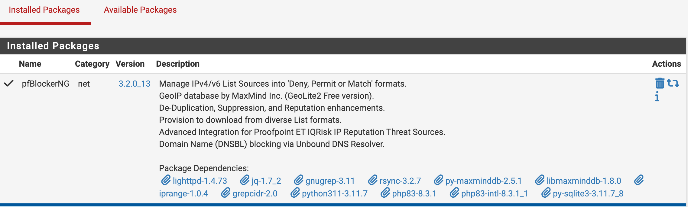

  • pfBlockerNG 3.2.0_13
    188 Views
